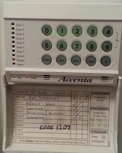

frenzy382 Posted September 27, 2022 Posted September 27, 2022 Hi, So i have a very basic Prog 3 setup. It literally covers Zone 1 (front door) and that is it. I used to have it that at night, I would set Prog 3, it would arm and I would sleep peacefully. Anyway...long story short, I was fiddling about with it a while ago, trying to make it simpler for a friend of ours to use Prog 1 (whilst we were on holiday) and I reckon i've messed up Prog 3. The only way i can get Prog 3 to work is to ensure it has an exit mode, which is currently set to 'timed'. It used to be disabled, and on reading all the manuals, even the default is set to disabled. Any idea as to why this won't work when set to 'disabled'. Also, even in 'timed' mode, I'm unable to change the exit time (which is currently 30 seconds)...it's not even an option it will allow me to select.... Any ideas? thnx Quote

frenzy382 Posted September 29, 2022 Author Posted September 29, 2022 (edited) just to confirm/update... is it a g3 pane?....i think it is. It's one of these https://www.smartsecurity.guide/wp-content/uploads/2018/10/00_ACCENTA_G3-400x502.jpg As far as being able to set to timed or silent...I can only set to disable, or timed. I get a flat beep sound on anything else. So...at the moment for Prog 3, I have one used zone...which is Zone 1, which is the front door. That's all there is.. Not sure if it helps, but ALL zone types are - Secuirty. Just thought i'd put that in there, in case someone thinks it's set to something else. So, my key sequence to try and set to silent is. Prog - 1234 (example) - Prog - 3 - 6 -4. nothing... Just tried the same to Prog 2...same problem. I thought it might be because it needs an 'exit time' set. But i can't set that either...another flat beep. Aargh!!!!!!!!! Edited September 29, 2022 by frenzy382 Quote
