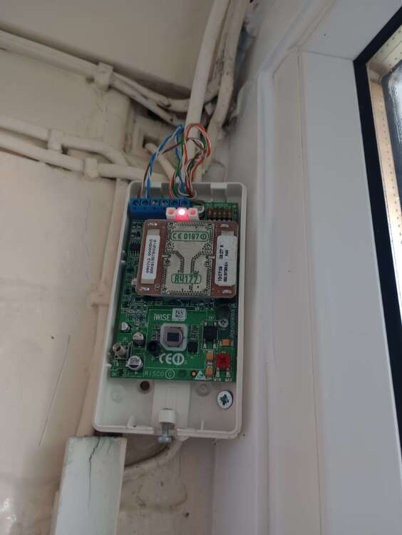

MrHappy Posted October 31, 2022 Posted October 31, 2022 14 minutes ago, Imnotshankled said: I never had that call out before but I have had lots of business where people bought new houses with non functioning alarms Last week DSC1510 to Euro Mini so the new owner would have a working a alarm, They had a Risco Dt added to the system in cat5 which just lit up- Quote Mr Veritas God
