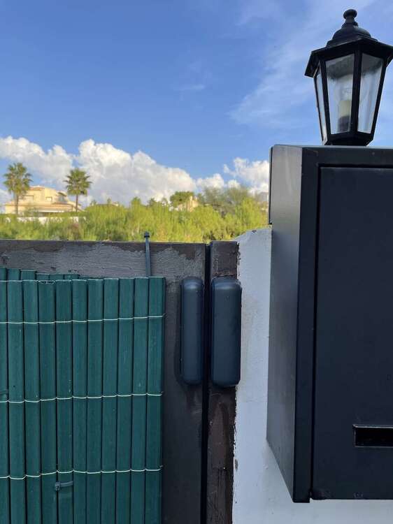

I have fitted a Pyrinox External MC Wireless Magnetic contact to my pedestrian access gate.
I wanted to know if and how, I could program the input as a silent alarm. That is, so that it will not trigger the main Enforcer alarm, instead, sending a HU alert to the HomeControl2 app.
The reason for this is so I can check when the Poolman/gardner comes onto the property. Also if anyone kicks the lock to get in (squatters).

You can set that zone to 13 day alarm  and then go to volume control and set day alarm volume to 0
If you want it as a silent HU input set zone to 4
