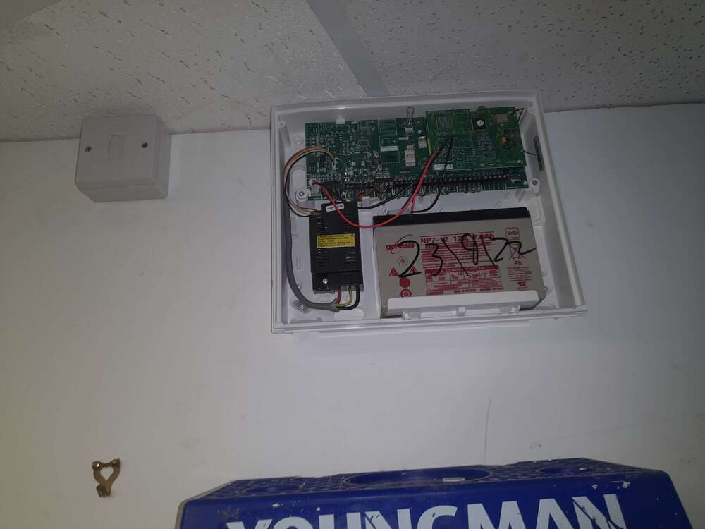

If not you can add a buzzer in the panel if it has a on board keypad
The panel shouldn't loose it's memory like this, the charging rate should also be checked with a meter upon replacement.
The loudspeakers can fail if it's the built-in ones or maybe the speaker wire snapped or come loose if your only hearing keypad clicks and you think it was louder.
Early 1996 veritas panels have no NVM protection
The part set exit and entry tone is supposed to be a clicking tone and you only get a beep at the last 10 seconds
The hardware changed in 2000.
"Non-voliate memory" retaining programming is in the name... a panel is useless if it looses its memory upon power loss or faulty battery, no matter what is broken.
Generally if they loose memory once, they'll do it again no matter which hardware revision Veritas
Yes, the clicking is correct, I didn't question that if you read...
