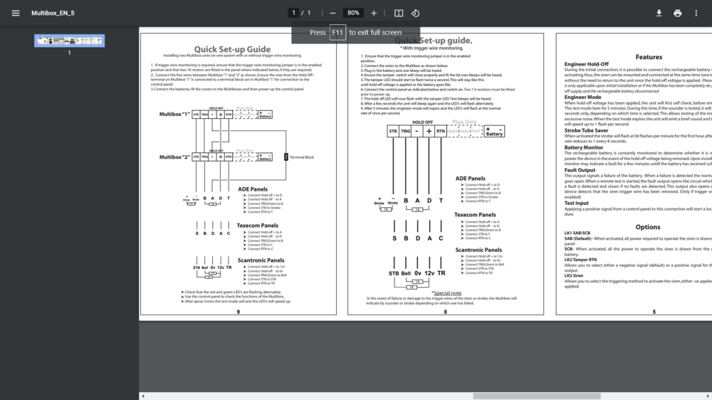

privatesam Posted April 19, 2023 Posted April 19, 2023 I'm seeking advice about why my external sounder may be malfunctioning. Several years ago I installed a DSC Powerseries alarm panel with some zone expanders and an output expander PC5204. I opted for the PC5204 because I was concerned about the amount of amps the external sounder, internal sounder and strobes would pull when the system was in alarm. Installation was fine and the system functioned fine. We haven't had need to set the alarm for a few years but recently I decided to double check it was all working ok and noticed that the external sounder no longer was functioning correctly. The external sounder is a CQR Multibox Plus. The problem is I can't get the sounder to trigger at all except for when I remove the hold up voltage and then it is obviously using the internal battery. I assumed that the trigger wire had corroded or something so got the ladder out went up and used one of the unused wires (8 core) at the box to connect a new trigger wire - I used a tone tester on the new wire to check it worked. I noticed when I went up the ladder to remove the cover but with the Hold Off voltage still applied that the sounder went off because I obviously tripped the tamper switch - so by all accounts the multibox is functioning ok. Anyway I put everything back together - ran some tests and it was working. A few days later I decided to double check and its not working again! I decided to change the wiring at the panel end and see what happens if I wired the sounder to the DSC1864 main panel instead of the 5204 but had the same problem. Its very annoying because every time I remove the Hold Off + voltage the sounder goes off so there's nothing wrong with the actual bell bit and the strobe works and is triggered fine. Could there be a malfunction with the trigger terminal on the Multibox? Is there some quirk to sounders that some experts here could suggest. Here is my current wiring breakdown with Multibox directly on to 1864 panel: CQR Multibox ------ DSC 1864 Trig -------- Bell - STB -------- PGM2 RTN -------- Zone 7 Hold Off - ----------- AU - Hold Off + ----------- Bell + Here was my wiring which was working into the PC5204: CQR Multibox ------ PC5204 Trig -------- PGM3 STB -------- PGM2 RTN -------- Zone 7 Hold Off - ----------- BLK Hold Off + ----------- Aux+ I've attached pictures below to help illustrate and adding links to full manauls. Any help gratefully received! Here is the full PC5204 manual: https://cms.dsc.com/download.php?t=1&id=16978 Here is the full multibox manual: https://drive.google.com/file/d/0BxrZ6glh1lA4WWpIeGF1T3duQ1k/view?usp=sharing&resourcekey=0-ABBXRukm_a2O7VVrDwBV-w Here is the full DSC 1864 manual: https://drive.google.com/file/d/0BxrZ6glh1lA4b25hY05ZN1J4Nlk/view?usp=sharing&resourcekey=0-yRDTDFKU9IzTdyTqfXja1w Quote

privatesam Posted April 19, 2023 Author Posted April 19, 2023 2 hours ago, MrHappy said: g3 needs resistors for trigger monitoring ect... the values stated in the book might not be quite right for your controls Interesting but there's no reference to resistors in the manual and to be honest I'm not trying to monitor for faults on trigger or anything - I'm simply looking to see if I can activate the sounder. I have even tried simply touching the trigger wire at the panel end on to the aux - just to try and activate the sounder but nothing. Quote
james.wilson Posted April 19, 2023 Posted April 19, 2023 if there is 12v across the Bell trig and hold off pos and 12v across hold off pod and beg it should be sounding. there shouldn't be 12v across ho pos and Bell trig normally you dont need the resistoer looking at your image as you have trigger monitoring enabled Quote securitywarehouse Security Supplies from Security Warehouse Trade Members please contact us for your TSI vetted trade discount.
MrHappy Posted April 19, 2023 Posted April 19, 2023 2 hours ago, privatesam said: Interesting but there's no reference to resistors in the manual and to be honest I'm not trying to monitor for faults on trigger or anything - I'm simply looking to see if I can activate the sounder. I have even tried simply touching the trigger wire at the panel end on to the aux - just to try and activate the sounder but nothing. I doubt the plus version will work without resistors- then again what would I know- Quote Mr Veritas God
james.wilson Posted April 19, 2023 Posted April 19, 2023 Ah are you thinking pull up resistor? Quote securitywarehouse Security Supplies from Security Warehouse Trade Members please contact us for your TSI vetted trade discount.
MrHappy Posted April 19, 2023 Posted April 19, 2023 37 minutes ago, james.wilson said: Ah are you thinking pull up resistor? I'm thinking new controls & new bell... Quote Mr Veritas God
