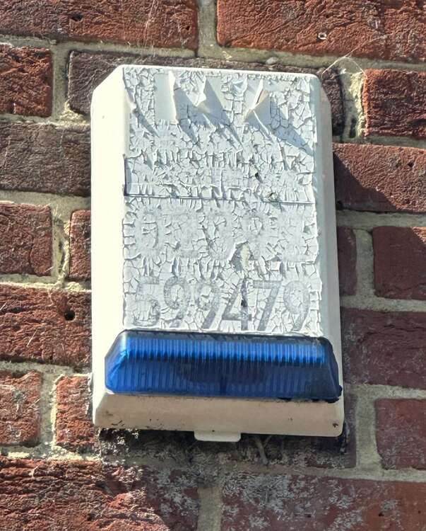

Thanks for the reply and decommissioning sounds much more sensible. I’m happy to get up to the siren and disable it. Not sure what kind it is as the label isn’t legible anymore (have attached photo though).
Is it simple enough diy job to disable siren once cover is off? I’m assuming removing the cover will cause alarm to sound anyway and then it needs the incoming wires disconnecting and battery removed?

At that age fixings and hardware are usually seized. Disturbing any tamper circuit on a siren should trigger external and internal alarms.
They are all different designs for the electronics inside, we are not a resource to teach people how to disable systems...
The strobe is usually high voltage and will knock you off your ladders, so be careful what you poke.
