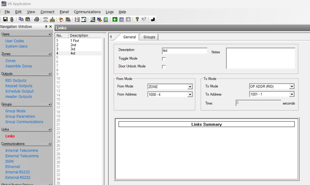

Cieska Posted January 17, 2024 Posted January 17, 2024 Hi boys and girls, I'm designing a one function for intruder alarm based on Honeywell Dimension Galaxy. I have got multiple panic alarm buttons and multiple relay outputs. I guess it will be Honeywell C074 Galaxy Series 4-Way Relay Interface and i would guess this will be connected on pin header. All will be as 24hour type of inputs and I need: when one or another zone (panic button) activated, to trigger one or another output, which will be C074. So if Zone1 activated Out1 activated, if Z2 activated out2 activated and so on. and keep output active until it zone changes the state. And keep normal 24hour zone monitoring as normal. I wonder if for that I will need to use Links (Option 54)? So before I will try to get all toughener I would need that some one confirm that is valid concept? So if I still missing something or maybe this totally nonsense? Any other info you need for this technical bit? Thank you. Quote

sixwheeledbeast Posted January 17, 2024 Posted January 17, 2024 Some manufacturers have an output option of "Zone Mimic" which you then just select the zone you want to mimic. Job done. I'd imagine you'd have to use Links on a Gal, I'd be surprised if there isn't an example for something like that in the manual... Quote
james.wilson Posted January 17, 2024 Posted January 17, 2024 yeah you could use links for this and progam the circuts as PA Quote securitywarehouse Security Supplies from Security Warehouse Trade Members please contact us for your TSI vetted trade discount.
Cieska Posted January 22, 2024 Author Posted January 22, 2024 Easy, just like that. Thanks boys. Quote
