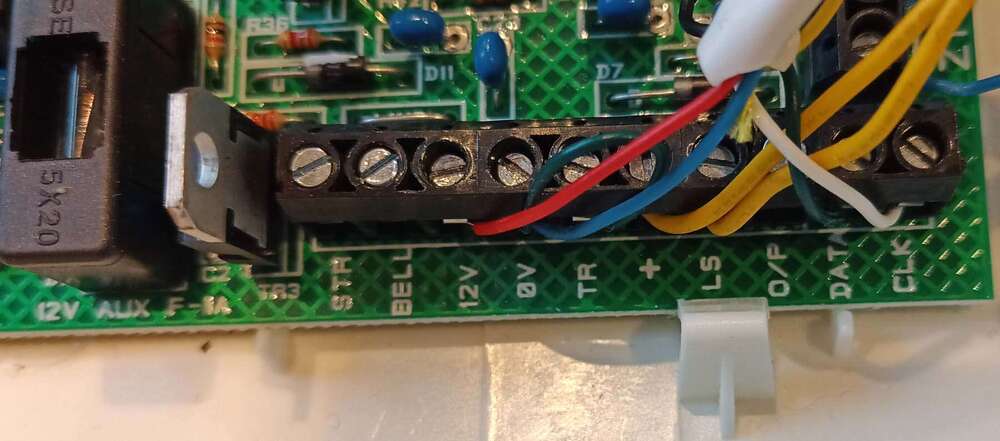

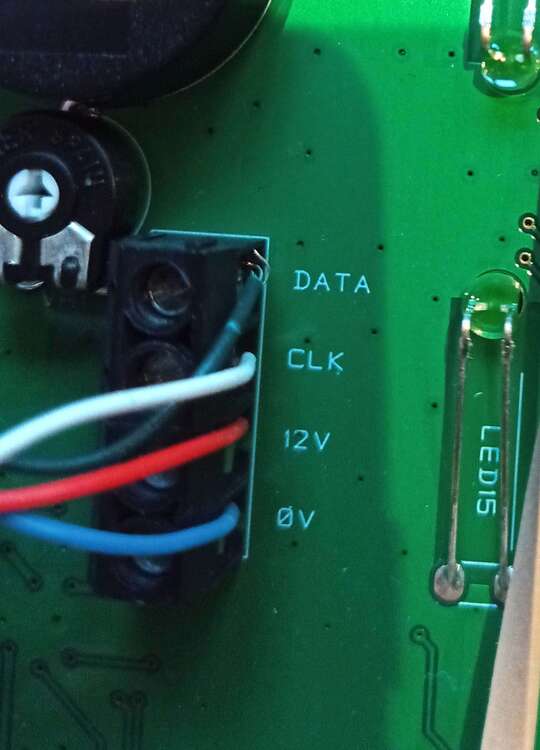

james.wilson Posted February 26, 2024 Posted February 26, 2024 maybe post a picture of the main board connections i dont know the panel Quote securitywarehouse Security Supplies from Security Warehouse Trade Members please contact us for your TSI vetted trade discount.

james.wilson Posted February 27, 2024 Posted February 27, 2024 agreed its either a duff ebay special or wired wrong somehere, hence why i asked for the pic of the main board wired in Quote securitywarehouse Security Supplies from Security Warehouse Trade Members please contact us for your TSI vetted trade discount.
SalopMan Posted February 28, 2024 Author Posted February 28, 2024 Thank you both for your help with this. Photos are attached. Quote
SalopMan Posted February 28, 2024 Author Posted February 28, 2024 Sorry, I missed one photo out ! Here it is. Quote
