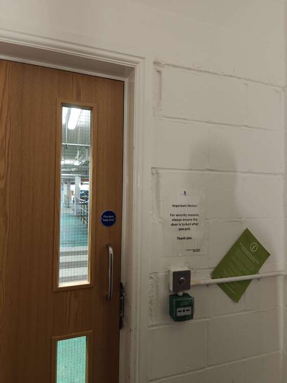

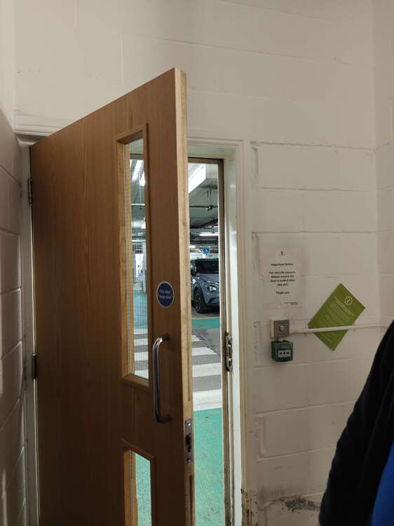

al-yeti Posted Thursday at 14:05 Posted Thursday at 14:05 How would you put a maglock here ?as standard lock keeps failing as it's being forced open over time Quote

PeterJames Posted Thursday at 20:49 Posted Thursday at 20:49 You could maybe fit a morticed shear mag, or a shoot bolt. But I would probably go with Steves idea and fit an external mag on the outside and use star screws or anti tamper screw heads to prevent someone unscrewing it or a architectural mag https://www.cdvi.co.uk/products/categories/magnetic-architectural-handles/ Quote

MrHappy Posted 8 hours ago Posted 8 hours ago (edited) rim releases normally fall to bit by the machine screws falling out thread lock helps its either the door slamming or cnuts braying the door... a shear lock is very dear ! Edited 8 hours ago by MrHappy Quote Mr Veritas God
al-yeti Posted 6 hours ago Author Posted 6 hours ago 2 hours ago, MrHappy said: rim releases normally fall to bit by the machine screws falling out thread lock helps its either the door slamming or cnuts braying the door... a shear lock is very dear ! Shear lock seems the way, although I never done one of those, don't seem to difficult, just need to get some tape to fix it on Guy in this building doesn't mind spending Any examples of shears on how your fitting them ? Quote
