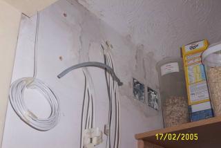

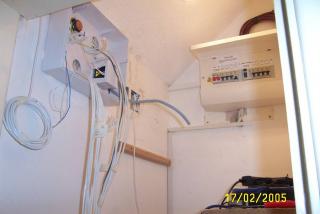

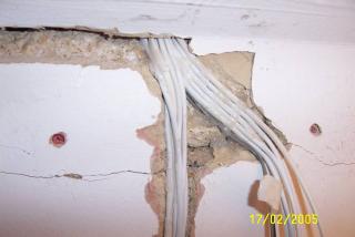

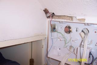

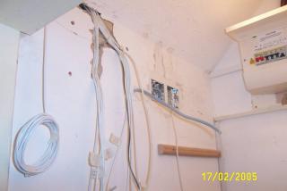

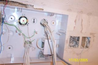

Here are some more pics, all the wiring is run now, still got a lot of it to chase in the walls though.

The cable is run now, I have kept it away from mains wherever possible, but there are places where the cable unavoidably crosses a mains cable. The cable is chased into the walls just under the coving in places where it was not possible to get the floor up and in a few places it crosses the 240V cable going down to swithches or sockets. Its not like it is running parallel with mains just crossing at one point.
