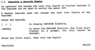

Did this come to a conclusion as I have a Shorrock 1500 and need to change the code. Any assistance gratefully received B)
Hi
Are you talking about the 1500 where you power down batts and mains and code is **** on power up ?

No default codes please
i uploaded a 1500 manual ages ago should be there somewere :yes:
2.1.3

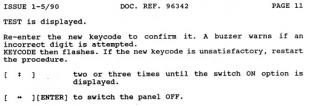

to change keycode enter the current code (switches the panel on ) press the # key enter the new code then re-enter the new code to switch the panel off first digit of a customer keycode must not be 0.
regards ric.
2.1.3
regards ric.
